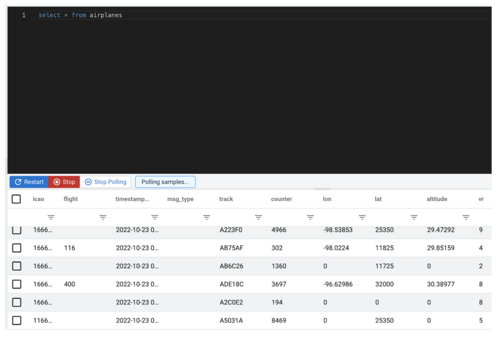

The ADSB raw data queried using SSB looks similar to the following:
For the purposes of this example we will omit the explanation of how to set up a data provider and how to create a table we can query. But let’s assume we have already set up such a table, based off of a Kafka topic that has the ADSB data streaming through it, and we have named it airplanes. Please check our documentation to see how that’s done.
The raw data above could be acquired by simply issuing the following SQL statement:
SELECT * FROM airplanes;

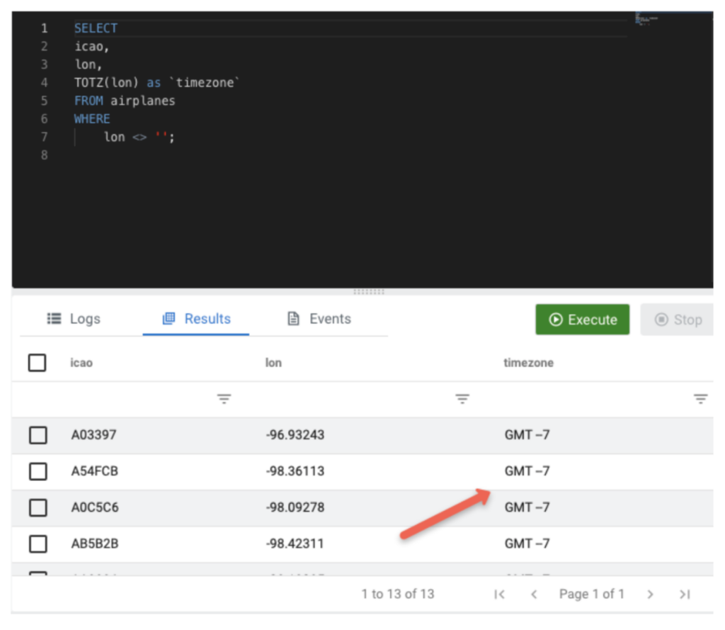

As we stated earlier we would like to deal with the longitude values and use them to be able to generate a time zone in the usual GMT +-<offset> format. We are also not interested in rows that don’t contain a longitude so we can exclude those. We can also exclude most columns other than the icao, lon and the value we will generate. To achieve our goal, the SQL we require might look something like this:
SELECT
icao,
lon,
TOTZ(lon) as `timezone`
FROM airplanes
WHERE
lon <> ‘’;

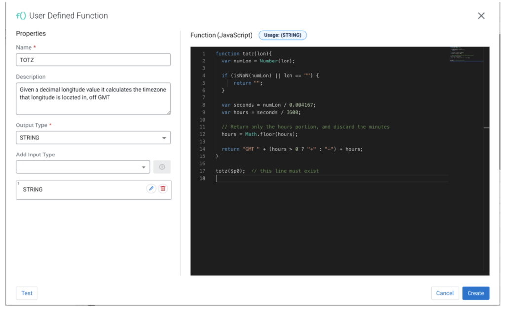

Thus our function should output “GMT -10”. Currently UDFs can be crafted using the JavaScript programming language in SSB (and Java UDFs can be uploaded, but in our post we are using JS). By right clicking on “Functions” and then the “New Function” button, a user can create a new UDF. A popup opens up and the UDF can be created. The UDF requires a “Name” one or more “Input Type”, an “Output Type” and the function body itself. The JS code has just one requirement, and that is that the last line must return the output value. The code receives the input value as the variable named “$p0”. In our case $p0 is the longitude value.
In case we want to pass multiple parameters to our function that can be done as well, we only need to make sure to adapt the last line accordingly and add the proper input types. For example if we have function myFunction(a, b, c) { ... }, the last line should be myFunction($p0, $p1, $p2), and we should match the number and kind of the “Input Types” as well.
UDF code using Javascript programming
UDF code
function totz(lon){
  var numLon = Number(lon);
  if (isNaN(numLon) || lon == "") {
      return "";
  var seconds = numLon / 0.004167;
  var hours = seconds / 3600;
  // Return only the hours portion, and discard the minutes
  hours = Math.floor(hours);
  return "GMT " + (hours > 0 ? "+" : "-") + hours;
totz($p0);  // this line must exist
Testing the UDF
After creating our UDF we can try our SQL and see what it produces.
Creating UDF and trying SQL and see what it produces
Our TOTZ UDF did the job! We were able to quickly and easily extend the SQL language, and use the new UDF as if it was a native SQL function, and based off of the longitude value it was able to produce a string representing the time zone that the plane is flying through at the time.
